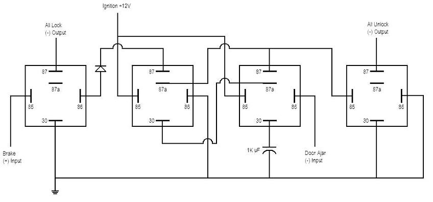

After checking schematics on the site, I wanted to add auto lock/unlock to my 2000 Ford Pig, er.. Excursion.  I wanted to modify the provided diagrams so that the locks reset each time a door was opened.
A few spare components and a six pack later I got this:
Add Auto Lock, Unlock to 2000 Excursion, F-250 - FYI - Last Post -- posted image.
The doors only lock when the doors are closed the first time the brake is pressed after starting the vehicle or opening a door.  By not using a resistor with the capacitor the charge is stored and the doors auto unlock when any door is opened or when the ignition is turned off.
Works like a charm.  Timmy!
