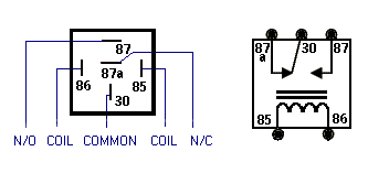

hello,
   Im wiring up this motec system in a car and I just wanted someone to confirm to make sure I have these 3 relays correct.
motec system, relays correct? -- posted image.
napier
Joined: February 26, 2006
Posted: December 14, 2006 at 9:26 PM / IP Logged
Hi,
  Im wiring up this ecu and I wanna make sure i have all the wires going to the relays at the right spots on the relays.  Here is the pic:

the numbers are right for the function listed.motec system, relays correct? -- posted image.

I was just confused because if you look at the one the furthest down it seems like there is no ground

What does note 3, 4, and 5 say?
It looks like the relay in question  gets a ground from Aux 4 input.
Aux 1, Aux 2, and Aux 3 also get their ground somewhere else
