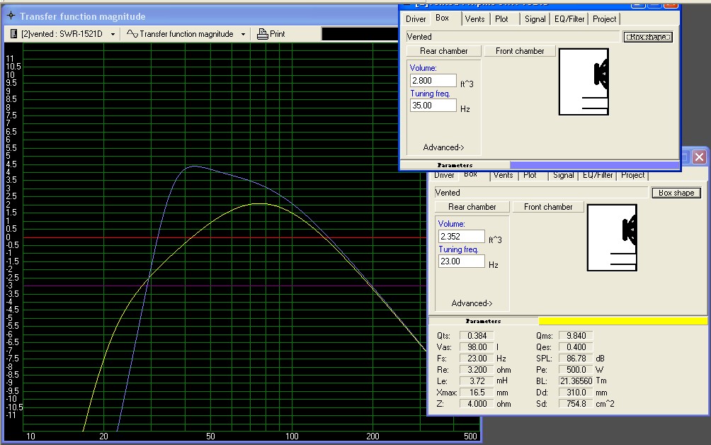

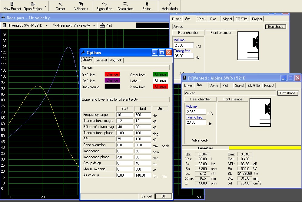

Look over the following two file pics.  The first shows frequency response for the 2.8 cu ft 35Hz Fb box you stated that WinISD gave you, which is the blue line.  The other, the yellow line, is a 2.3 cu ft box tuned to 23 Hz.  You'll also see port noise for the two alignments.  If you will follow up later and also look at cone excursion for the two, you will see that the "yellow" is safe, but the "blue" is unsafe without a highpass filter.
As you are working on this project, bear in mind that whatever you add to the inside of the enclosure will count as displacement against the airspace.  If there truly is 2.8 cu ft net now, the port structure that you add will take away from that space.  Now, this box will need a somewhat sizeable port and you will have to be careful in how big you let it get.  In a series of trade-offs, you want the best natural reponse you can get with the least amount of port structure.  The port is very short in the "blue" box (at 7"), but the response is not acceptable, nor is the port noise, as you will begin to understand as you look at the graph I provided.  The "yellow" has a longish 24" long, 4" round port but the displacement is workable with your existing box and the port noise is acceptable.  You will also find that if you use two ports, each port will be twice the length of the single port...which will add too much to displacement.  I suggest one port about 4" round for this box given the driver receives up to 500 watts RMS.
As you will read in the guide, you can make changes to your graph parameters.  For port noise, you want it to read feet/second (in the "rear port air velocity" chart).  Make the top end of your graph 140 ft/sec and the bottom end 0.  Right-click on any graph to get the "options" dialogue box (shown in one of the pics I provided).  Click on the parameters you want to adust.  For port noise, you don't want it to go higher than 110 ft/sec for a car audio sub.  That's 1/10 Mach.  Ideal is half or less than that, but that is where the never-ending trade-offs come into play.  Increasing the port opening and, thus, the volume will lower the port noise but will result in more displacement of air taken away from your enclosure.
