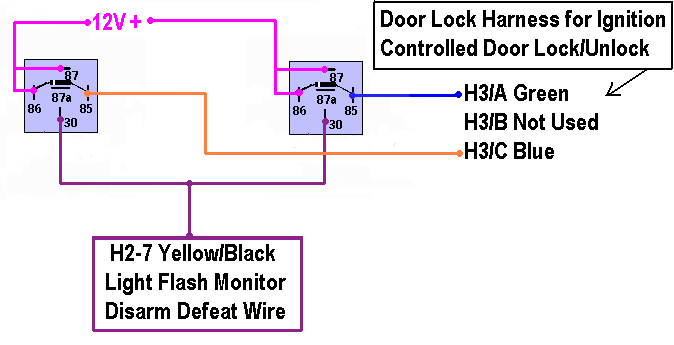

Another problem that I was experienced during my intalation on my Toyota Prado was that there was noy way the RED or YELLOW/Black DEFEAT Wire to get it to work.
So when the alarm goes off if I hit the factory unlock or lock switch located on the car door I can disarm the alarm DEI 727T Problems -- posted image.
So here is how I cure this problemo:
The good thing of using this method if that when I am driving the car and I remove the key from the ignition, pressing the LOCK/UNLOCK switch on the drivers door, does not activate the alarm accidentaly. So the only way to activate the alarm is with the Key FOB transmitter.

Posted: January 07, 2007 at 7:26 PM / IP Logged
Also forgot to tell you that using the schematic above,
DO NOT CONNECT the RED defeat wires to NOTHING.
Also, Just connect the YELLOW/Black Defeat Wire "ONLY" to the relays. DO NOT Connect the YELLOW/Black Defeat Wire to the light flash, or status Led as indicated on the instrucction.
Any questions, let me know,
