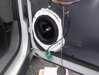

Example of a homemade spacer.  I used some particle board that was salvaged from some thrown away furniture (not the best material to use but it can be waterproofed pretty well with urethane).  The surface is white because that was the paint color of the furniture.  Cut the piece to fit your door;  the door panel will hide its ugliness, so it doesn't have to be pretty.  Cut the hole so that the speaker fits into it.  In this case I recessed the hole with a routed mortise so that the driver fit flushed.  The baffle is screwed into the door sheet metal and then caulked all around the edge for a good seal.

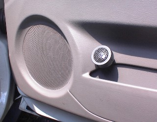

Keep in mind the room that is needed between the driver surround and the door panel that you have to put back over it...as well as (mentioned already) the room behind the driver's magnet.  You can fit just about any size driver into any size hole using a baffle like this.  This one is a 6.5 driver fitting into a 5.25 hole.
Altering door to fit 6.5 splits. -- posted image.
After door panel is reinstalled:
