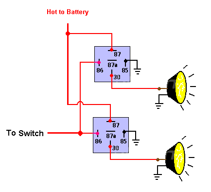

Hello folks.
I have the basics down about relay's and can wire in a single relay to power a pair of lights (my backup lights to be exact). I want to add a pair of them, what wires am I supposed to double up and what goes where, I tried a few different combinations of wires and kept blowing fuses.

Wanted to have a relay for each light.

Posted: December 27, 2006 at 11:15 PM / IP Logged
Wiring In 2 Relays? -- posted image.

Posted: December 28, 2006 at 8:02 PM / IP Logged
It does not matter why.
He wants what he wants so we just give him the circuit.Wiring In 2 Relays? -- posted image.
