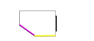

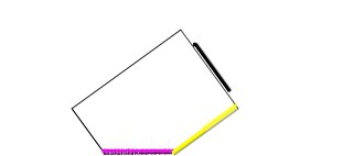

This is more work and a bit more expense, but your best bet is to build a mock-up MDF box of the same cu ft as your intended permanent enclosure.  You might build it along the lines of this example so that you can experiment with aiming and tilt.  Find what sounds best to you, and works with the rest of your system...which may or may not be the loudest it can be!
You can then sell the box to a friend.
