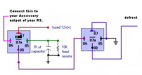

I've search "defrost" to death so far and learned a ton about how to connect it to get it to work w/ the R/S.
However, my remote starter has a GWR (ground while running) -250mA wire that I need to use in order to connect my defroster to work.  However, I have learned that the (-) charge to the wire coming off the defroster switch must be "pulsed."  How can I convert my constant GWR (-) charge to a pulsed negative charge to initiate the defroster during remote starts?

Installed an Ultrastart 1270TL (r/s, doorlocks all work great).
I have an auxillary output -- the ground-while-running wire that provides the -250mA charge during the operation of the remote starter --  so I figure I could use this to trip the defroster -- however, I know I need a "pulsed" negative charge to trip the defroster.  How can I convert a constant neg. charge to a pulsed one? Thanks

...to a pulsed ground output.  I'm trying to trigger a rear defroster and the Ultrastart 1270TL only has a constant ground-while-running -250mA output.  Is there a way to convert that to pulsed ground output?  (It is not possible to do this in the brain via programming).

You can achieve the effect but this drawing uses a +12V source like the ACC wire of your module
97 Maxima, how to connect rear defrost -- posted image.
