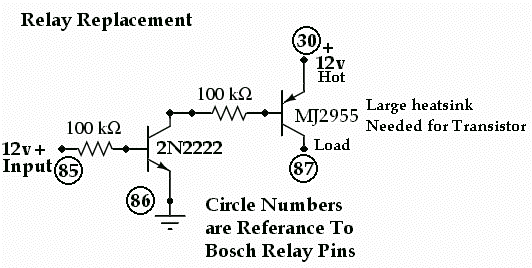

You'll need to go with solid state relays.  They switch much quicker the electromagnetic relays, are silent, and don't wear out.
Do a search on www.digikey.com for solid state relay
You didn't give much information (coil voltage, load voltage) so it's hard to tell you much more.

where can I get silent relays -- posted image.

I do not know that much about relays
I just need a basic solid state relay
they need to handle at least
4amps or more output
12-14 volts input and output
less than a or about 1/2 amp to trigger it
4 pin-SPST I need 8 of these right away
and 5 pin-SPDT I will need these in the future
