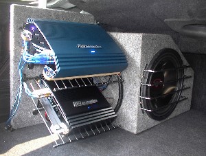

You can mount amps rightside-up in that location. Build a mount that is attached to that deck. Attach the amps to the platform on the mount. You can use a piece of plywood and long bolts to make the mounting platform. Fan-cooling an upside-down amp will not likely solve the heat problems.
Amp racks are "designer's choice". Use your imagination. In my personal car I have amps mounted onto plastic-coated wire shelving which are then mounted to a carpet-covered piece of vertical plywood. The shelving is held in place by angled braces called "shoe brackets" (or something like that), all found at Lowes in the closet department.
Amps upside down w/forced cooling? -- posted image.

You know, we always talk about how important the setup details are in a car system...damping, crossovers, enclosure design / strength, locations of speakers, and all that.  I put more in time spent to get everything to sound its best rather than money spent on equipment.  For a lower mid-grade system, this sounds very good.  $50 sub driver, less than 200 watts, gives me more sub bass than I need.

I designed that so that the wire shelving takes the energy and dissipates it before it goes into the amps.  It works good.  You can hardly feel a thing when you put your fingertips against those amps, system cranked.

No, not cooling.  Damping.  The amplifiers still get as warm as they usually would, but without the vibrations (energy) transferred into them from the car body I feel more comfortable with long life out of these amps with their (I assume to be) delicate circuits.
BTW, the class D mono amp never gets warm, but the same manufacturer's class A/B stereo amp gets almost hot.  Shows the difference in the two types' efficiency.  USacoustics...I think they may be a thing of the past.  I never see them anymore.
The popular way of making amp racks, in that the amp is recessed into a plywood or MDF panel in order to hide wiring, seems to me to be a bad way to mount them.  Yes, they look good that way, that is true.  But heat transfer is lessened because of the recessed, tight-fit mounting, and nothing is done about minimizing energy transfer from the car's body.  The vibrations may not be as much of an issue as I imagine, but there definitely has to be airflow under the amplifier to allow for heat escape out the top.
