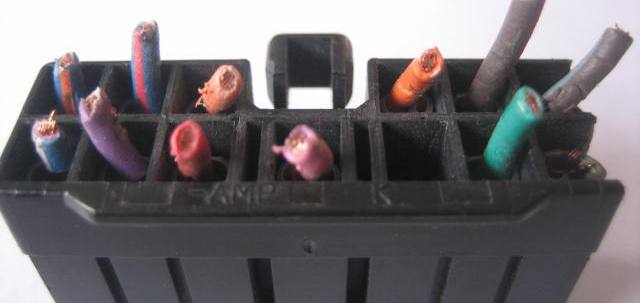

Hello all,
I have searched and browsed this site and others and the info I find does not match the colors of my wires for some reason.  Not sure if this is a factory plug or not but these are the wires I have:
1994 jeep wrangler stereo -- posted image.
the colors are:  back row left to right:  blue/orange, blue/red, orange, ORANGE / white, grey/red, grey/blue
front row left to right: blue/white, purple, red, pink, open, green, BLACK / YELLOW
Any help would be greatly appreciated!
Thanks

Posted: February 02, 2007 at 2:18 AM / IP Logged
blue/orange <> right rear -
blue/red <> front right -
orange <> dimmer
ORANGE / white <> illumination
grey/red <> front left -
grey/blue <> left rear -
blue/white <> right rear +
purple <> front right +
red <> ignition switched +12V
pink <> constant +12v
green <> front left +
BLACK / YELLOW <> left rear +
