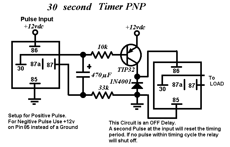

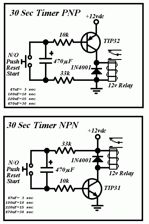

What you want can be done with a relay and a transistor a capacitor and a couple of resistors and a diode. You will have to play with the values of the 33k and the Capacitor.
When this circuit is activated it will stop the timer as long as the reset is pushed in. It the reset is open the timer starts counting down again. A relay can be substituted for the push switch.

Here is the same circuit with the second relay.
