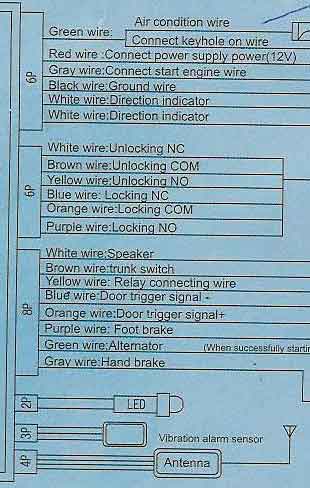

2001 s10, xplore alarm starter -- posted image.
only wire I see that might be suspect would be the one labled "relay connecting wire"

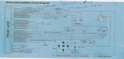

This diagram only shows the wires at the unit but is easier to read.

Problem solved:
The wire from the 457G Gm data interface that needed to go to a connection that read ground when engine was running...Used the wire from the Xplore module that went to the accessory line and jumped a wire over to a relay that I rigged to ground when the accessory line went positive.
The line from the xplore that needed a line that read pos while the engine was running: ran that line to the small red wire that came off the back of the alternator.
There were two door trigger wires coming from the Xplore unit. (-) (+). I used the (-) and wired to the tan wire and the purple wire located in the harness just to the side of the gas pedal. (used a diode on each line to prevent current from crossing back and forth between the purple and tan lines.
