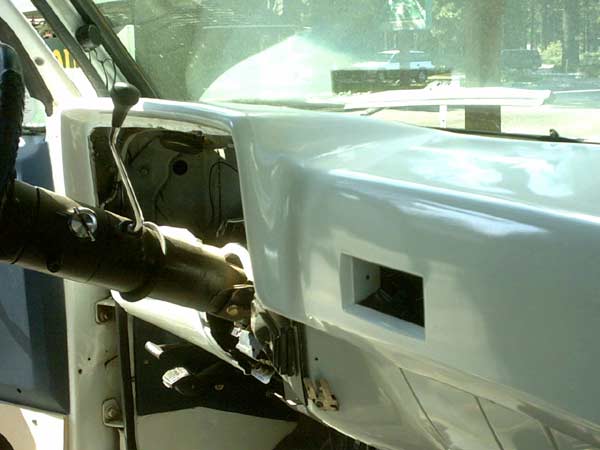

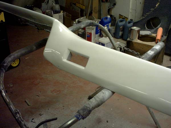

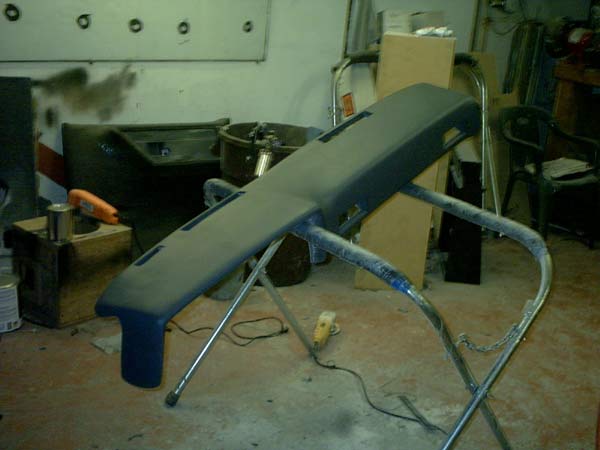

I think that bellsracer is right. I have glassed the dash of a mid 80s Chevy truck before that has that same type of vacuum formed vinyl over injected foam. I used a couple of layers of woven glass matt to reinforce the dash first. Glassing the corers and keeping the shape was no picnic. I was surprised to find that after a couple of days in the sun the dash buckled and cracked in the center like if someone took a hammer to it!. I remedied this by making the center (the most flexible part) thicker and consequently stronger. That worked. That was several years ago. Sorry I don’t have more pics but I stopped taking them after the first round of defeat. In the end it looked great and performed well but I don’t deal well with any amount of failure.

I have since learned about how much polyester resin shrinks and expands under various temperatures. I have pondered on how I would approach the same type of job I was asked to do it again, and I have settled on two different methods.
1. Use the type of filler that body shops use to repair soft bumper covers. This type of filler is epoxy based, flexible, and will bond directly to vinyl. This would give you a smooth but flexible surface. The draw back to this is that you are likely to end up with waves on larger surfaces that will stick out like a sore thumb when painted gloss. There is a reason why soft surfaces have a texture.
2. Use marine grade epoxy and do it pretty much the same way I did the first time. With glass matt. Epoxy expands and contracts 2% vs the 9% that polyester resin dose. Also Epoxy is effected by humidity much less than polyester.
I strongly suggest that you go to a wrecking yard and get some chunks of dash to experiment on.
