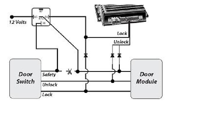

try this
lock: light GREEN/ black
unlock: lt.GREEN/ red
safety: RED / yellow
2006 tundra keyless entry problem -- posted image.

Posted: February 08, 2007 at 6:42 AM / IP Logged
cutter1122 wrote:
the good wire for your doorlock is     in driver door
Note: Meter these wire while turning the key in the driver door!
These are incorrect. Go with Cutters diagram, the wires are directly on the back of the drivers switch. The diode in the lock wire isn't needed. Use the thick blue wire on the switch for 12volts to power the relay.
