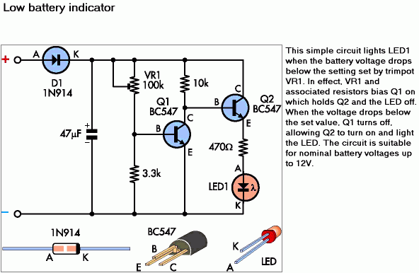

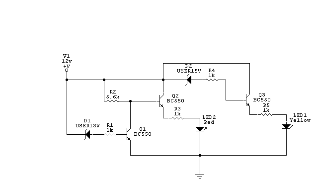

I like this idea . Lets see what we can come up with.
low voltage sensor ckt. -- posted image.

Posted: February 09, 2007 at 10:35 PM / IP Logged

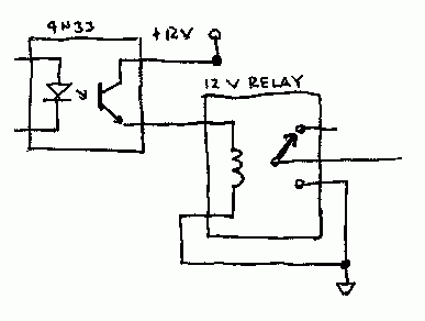

Posted: February 10, 2007 at 8:15 AM / IP Logged
with a Opto isolator where the led goes.
