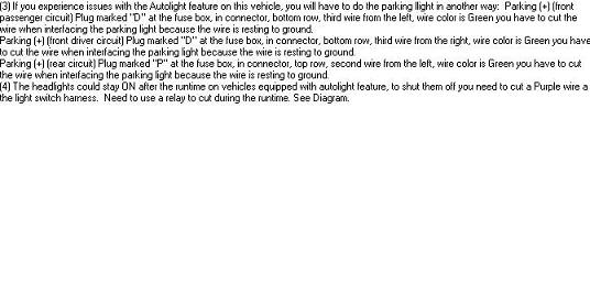

Posted: February 13, 2007 at 7:18 PM / IP Logged
2006 sienna remote start dei headlights -- posted image.2006 sienna remote start dei headlights -- posted image.

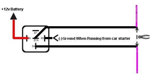

You need to "break" the auto light wire with a relay, so they do not come on during remote start. When I get home from work I will look it up and put up another post. Your relay will be triggered with a ground while running.
The lights should also "time out" and shut off......

Posted: February 13, 2007 at 7:21 PM / IP Logged
Well there you go then..............2006 sienna remote start dei headlights -- posted image.
