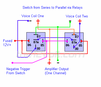

I am going to be using a couple relays for switching my dual 2 ohm sub from 4 ohms for daily chilling to 1 ohm for when I compete or show off to my friends.
How big of relays will I need to handle 1200 watts safely.

https://www.the12volt.com/relays/page5.asp#spvr
series parallel switching with relay -- posted image.
See the above for switching from series to parallel on the special applications relays page.  Compliments of the12volt.
While you know that the amperage draw from the 12 volt battery / alternator source is high, you also know that the amperage is reduced dramatically to the speaker because of the high voltage amplifier source.  40 amp relays will do the trick with room to spare.  Standard 30 amp relays would do the job, too, I'm sure.

Thanks Steve...I was thinking about 30 amp relays but I'll go with the 40 amp ones for some extra safety
