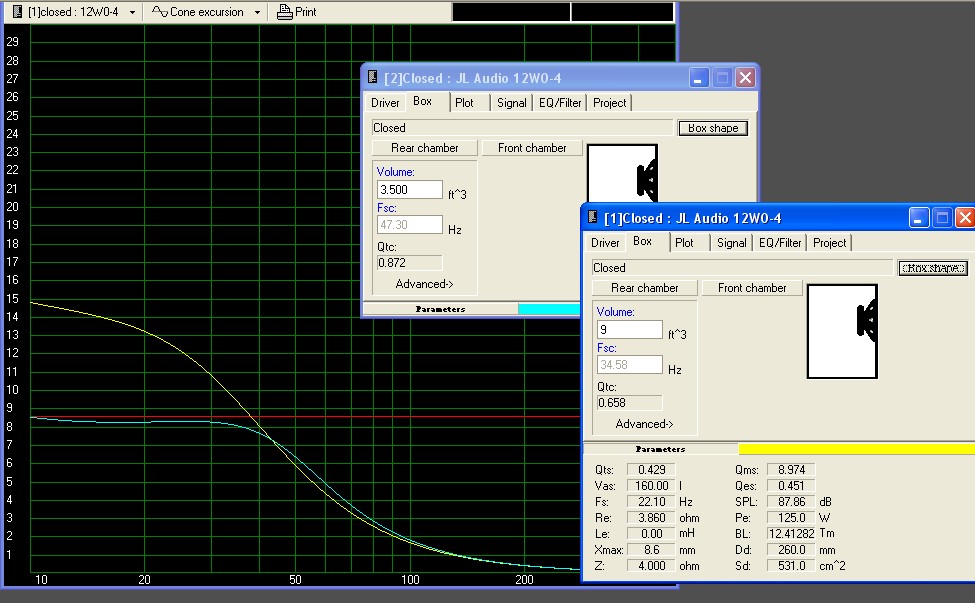

I would be concerned with the excursion of these subs.  With 8.6 mm Xmax and 100 watts, these subs will surpass the voice coil length at just about 40 Hz.  See the file:
You could make sure there's a highpass filter on the amp you power them with.  It would need at least a 12 db/octave filter at 30 Hz, or a 24 db/oct filter at 25 Hz to keep the subs healthy.  But you might also consider a sealed 3.5 cu ft enclosure on the trunk side of those subs rather than using the full trunk cavity.  No filter would be necessary that way.  You'd get slightly more SPL.
