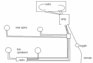

Thank you for the quick reply i understand most of it if not all. Im still a little blurry on how you would need to convert polarity and how that would keep the ammount of wiring down. Maybe if you could refer me to a good diagram that shows this ill be able to follow a lot better. since my alarm system is simple vats resistance. As far as my cuzins truck it does have a passive high pass filter. so my question is this how can i have it so when toggle is on bass is thru the subs when off it returns to rear speakers?

Btw the little box not labeled is high pass filter. would it be possible for me to put two relays before the high pass filter so if toggle is on then subs work and sound goes through the high pass if toggle is off then sound bypasses high pass and flows directly to rear speakers? is this correct thinking? also i would need two relays correct one for ground wires and one for power wires?

Correct me if Im wrong here audio gurus, but if a guy was to just splice off the rear speaks BEFORE the filter [I know this will mess with impedance a bit, but I have seen it done before.] You will get your bass back to the rears AND be sending the bas to the subs also.. Adding relays into audio works, but can definitly creat a buzz due to the electro magnet in the relay... If it's not a big buck system, I guess it would be worth a try...
