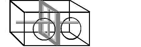

Also, keep in mind how  you are going to build in the bracing.  This box will certainly need at least one full-size interior baffle, and it should be front-to-back between the driver cutouts.  You can cut a large hole out of the baffle so that the box is all one interior volume, or you can use a solid baffle so that each sub has its own air space...same either way (I'd opt for the solid bracing baffle).  The face baffle gets the most pounding and is the weakest one of them all because of the cutouts.  And for a box this size, I'd use other bracing inside as well.  Here's an example:
subwoofer box dimensions needed -- posted image.
With a sealed box of this size, you don't really need to get too particular about measuring each piece of baffle material you use (takes up air space and is counted as "displacement").  Just skootch up the measurements of each dimension a little to make up for the displacement of bracing, drivers and baffle walls.  Like, a 22" W should become a 24", etc., which takes these material thicknesses into consideration.
