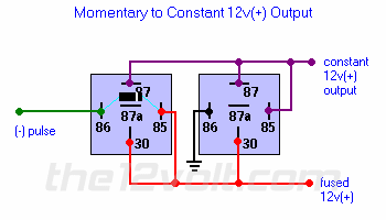

If you dont want something momentary, do this:
Momentary to Constant Output
Once activated by the relay on the left, the relay's coil on the right will stay energized until either ground or 12v(+) is removed. You can do this with another relay. Or try connecting to a 12v(+) switched source instead of a constant one. Or you can have a door trigger activate a relay to break continuity. The variations are practically endless.

I will look more into that momentary to constant switch.. I had thought something like that was possible, but didn't remember how to accomplish it.

As far as using the AUX output most DEI products will let you program outputs for several uses..momentary, timed, latched, validity so a relay will do it. If it is a basic unit and only has pulsed you can use a latching relay setup, very simply as well but as stated I don't really see the point.
