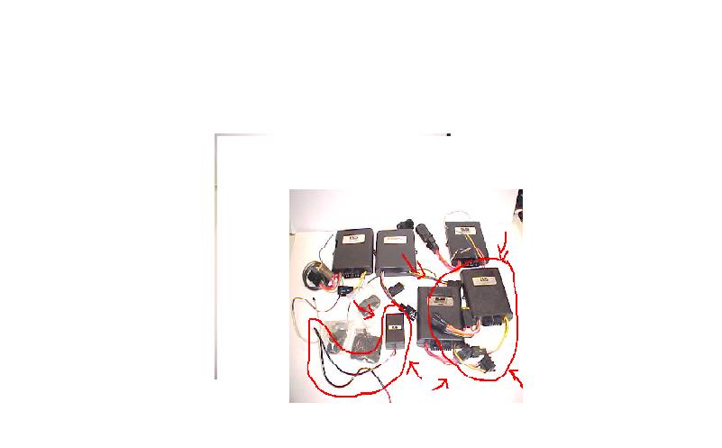

"ok...so i tore into my car again today and i found some intersting stuff. there is a Mopar EVS module installed on my car. From what i understand, the EVS is installed by the dealer, not the manufacturer. Also, it would make sense if it was a different system than factory for a few different reasons. First off, it would explain why my car was able to lock the doors when the alarm disables and the key is in the ignition (since the factory alarm isn't supposed to do that). Also, it would explain why there is no light green or GREEN/ blue wire connected to the ETACS. And finally, it would explain why the EVS was half-ass installed....with alot of the wires zip-tied, tucked, and taped wherever they would fit....including the alarm's horn i found dangling from one screw behind the driver's side headlight, tucked under an a/c hose (and apparently someone cut the negative wire to the horn...hmmm, i wonder why! :splat ). I found a pic of the EVS module and this other little EVS unit that was tucked behind the fuse box. The pic was actually used by someone on ebay to sell a few EVS parts, so I circled the ones that are identical to the ones in my car. The number off of the Mopar EVS module is 4636155. So please PLEASE someone tell me that they can help me. The best option would be to just completely remove the whole EVS system. I tried to figure that out while i was crammed under the driver-side dash but I got kinda lost when the wires started running in all different directions to things that I don't know anything about "

"well, after a week of working on my car whenever i could (probably twenty-something hours total) i finally got my car up and running again. I basically just had to track where the EVS wires went and remove them, then reconnect the OEM wires. It started to get difficult when i ran into some brown wires that ran to a relay behind the fuse block. The wires they were replaced with were two different blue ones, so I pretty much guessed on which one went where and I was actually right ;)  The only problem that I have now is that the dome light and trunk light don't work. I guess I'll have to find the fuse or relay for them and see if I blew it from removing and reconnecting of the negative battery cable so much.
It was a learning experience for me, which took many many hours to figure out (and don't plan on a dealership giving you any help whatsoever, because I called two dealerships and both of them said they had wiring diagrams but wouldn't even let me see them :cussing: )...but to someone that already got advice on the location of everything and which wires to cut and splice, it would probably end up being a little over an hours worth of work.
heres a pic of the modules

1994 intrepid alarm removal -- posted image.
