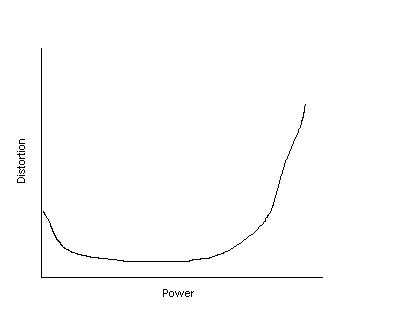

Thanks! It's what I do... good explanation of preamp voltage needed -- posted image. Many people don't know of linearity curves in amplifiers! I still have not been able to find an example of one on the 'net, yet... Still looking! (Forget it... here's a quick-n-dirty example of a typical amplifier distortion or "linearity" curve)
As I said, the numbers will change, based on many factors, but EVERY transistor has an efficiency curve, meaning: "at what voltage and current will this transistor amplify with the least destruction to the signal". Some manufacturers will actually choose transistors FOR the amplifiers, and are therefore able to actually DESIGN INTO the amplifier the cleanest curve available. Knowing that 90% of listening is usually done at 10 to 20 watts, if an amplifier is designed with this in mind, then you can have both high power, and clean response. Even if NOT designed with the transfer function in mind, every device will still exhibit a transfer function curve.
