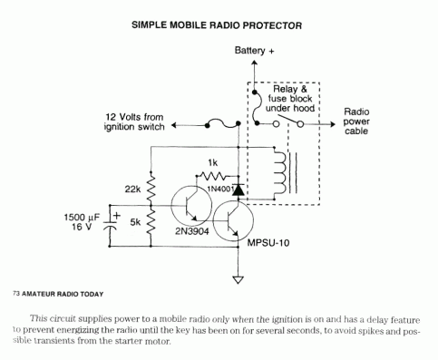

Probably not. The amp is turning on by recieving 12v+ at the remote wire regarless of thru a relay or not.
There are delay units out there that are very cheap if you do not wish to make one yourself using an RC circuit. A delay should help...but not always.
Let us know the vehicle and type of audio equipment as well..sometimes it is an inherant problem and we may know a definate cure, if possible.

amp pop could i use a relay -- posted image.
