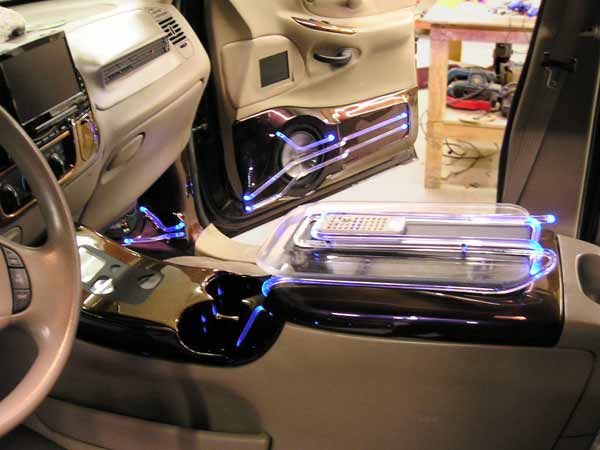

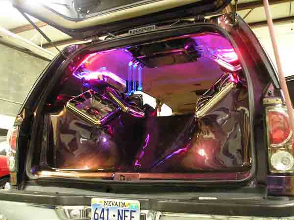

Most of us here have thought about doing this, or seen it done, or even tried it. It has been around for a while, it’s not new. Having said that I still don’t see enough of it around. I really like this look. Its cheep, fast to do, and I get very positive feed back every time I do it. I have a few tips for those who have not tried it yet, and I hope to encourage those who have considered doing this to try it.
easy lighting method -- posted image.
I have encountered a number of good installers that have tried this bent and lit plexi rod method and had a bad experience because they did not get the brightness and consistency of color that they were looking for. Like I have said I have had very good experiences with this and I believe that I know why. Before I decide to commit to this lighting theme in a vehicle I first consider a few things.
1.     will the rod be viewed an angle or strait on or both?
2.     Will the rod be in a place of darkness where the lighting effect will be vivid?
3.     If the rod will be out in the light will the rod look out of place if it is frosted white?
4.     Can the rod serve some other purpose other than light?
5.

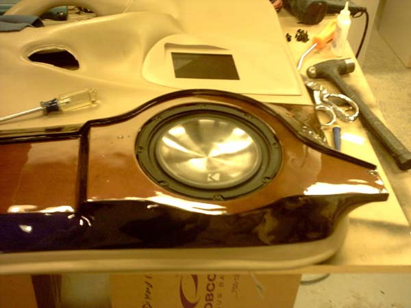

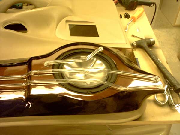

In the vehicle pictured above every lit rod-line serves has a function other than just light. I believe that this obvious functionality helps keep the lighting effect from looking to cheesy. On the center console the rod (that whole top piece is one rod 5 ft long) holds the remote. On the door the rods serve as a grill for the 8. on the kicks the rod continues the line from the door speaker to form a visual connection across the speaker system.

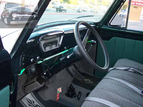

On this install the customer was going for the jukebox-neon beer sign kind of look to go with the Irish green theme. The rods where in direct sunlight all the time. I sanded the backs of the rods with 80 grit on a 3” DA. The rods look white when they are turned off. This white frosting makes the light kick off of the tubes and appears much brighter and uniform along the rod length.

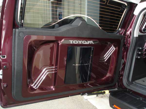

On this install the rods are also always in direct sun light. This is a system that we did for Infineon Raceway a Toyota sponsored NASCAR race track. The truck sits out near the track in the sun all day. The rods here represent wire running through the PS3, and they give three separate effects.
1.     Viewers don’t really stand directly in front of the door that this project is mounted on.
2.     The rods look really good even with no colored light.
3.     I put red LEDs in one side and blue LEDs on the other side of every rod. This way the color changes depending on where you stand. And it reflects nicely off of the paint

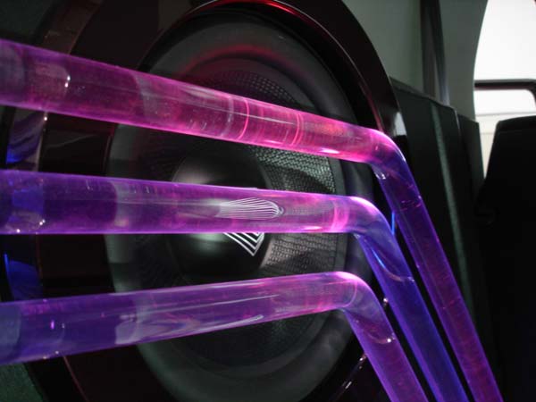

Inside Cody used the same colors on larger rods to make a speaker grill. Viewers always see these rods from an angle and they are in the dark. Consequently they are always bright.

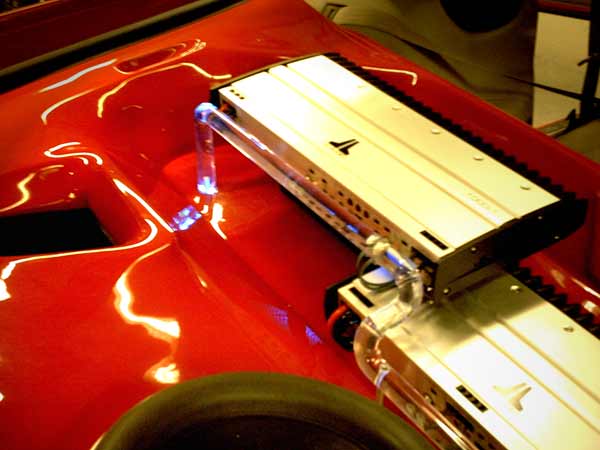

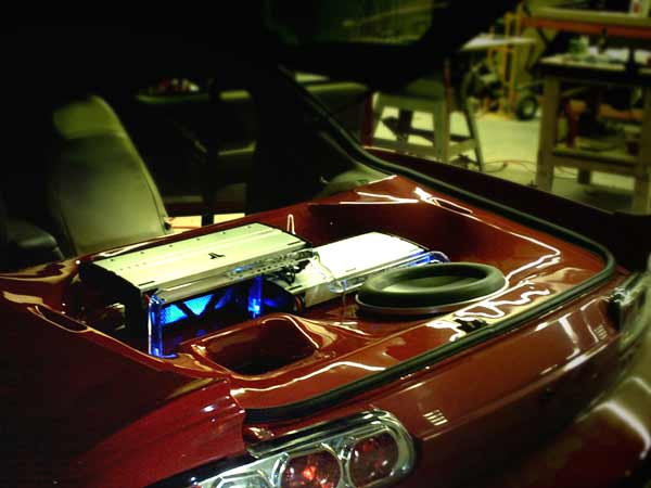

And here I used the plexi rod to hide the wiring on these amps.
The rod is transparent but it defuses the light and makes it real hard to see the RCAs, speaker wire, and power wire running into these amps. Also notice that the rod dives right into the painted amp rack. You can use a paddle bit the same size as the rod to drill right into fiberglass and you wont be able to see through the rod like you would think.
Heat any size rod up to 1” with a heat gun and bend to desired angle when soft enough.
Plastic stays flexible for several minuets.
Don’t get heat gun to close or the plastic will bubble.
Don’t worry about small bubbles, they sometimes look cool.
Some installers prefer to build jigs to hold the rods in perfect form while they cool.
I prefer to bend by hand and spray with glass cleaner to speed up the cooling when I get the angle right. You can always heat it up again.
The LED dose not have to be right up against the end of the rod. On several of my projects the LED is set back a couple of inches (for mounting purposes), and it looks the same.
Plug all of your LEDs into your 12V drill battery and test your lighting arrangement before you commit.
Cheap LEDs from SoundQuest (Stinger) seem to work as good as any. They are available at every store that carries Stinger.
I want to see some pics of what other people are doing with this. Post some replies with some info on your experiences.

I hold the heat gun about 5-7” away from the plexi. If I see bubbles start to appear I stop and let the plexi cool all the way down, and then start over. Like I said some bubbles don’t look bad but a bunch looks real bad. I have found that holding the heat gun farther away and continuing to heat the joint doesn’t really work because of the way that heat travels through plexi. Heat will build up in one spot and then gradually spread out in order to dissipate its self. If you over heat one spot you must stop because that spot will continue to over heat at a faster rate than the rest of the plastic.You will notice when you try heating a rod that once you have heated the plexi enough to bend it that it will continue to get even softer after you have removed the heat. This is because as the heat dissipates its self it spreads more evenly through out the rod even as it cools. This all sounds tricky but the reality is that its quite simple to do. Just pick up some plexi rod (its cheep) and try it.
Its also worth mentioning that I have tried many special tips and expensive regulated guns and they don’t do anything for you. I use a good old 25$ Wagner.
Recently I have come a cross half round plexi rod. This stuff bends nicely without loosing its profile and it lays flat. Laying flat has many advantages when it comes to mounting.
I found this stuff for $3.60 for a 6 foot section at www.tapplastics.com
