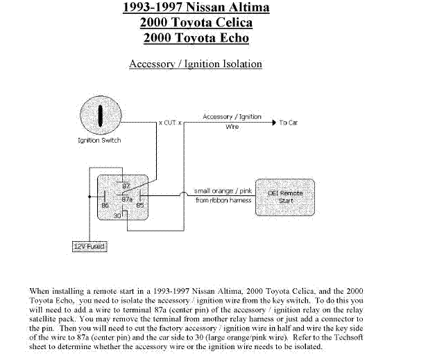

Does anyone know what Direct Fax # 1077 is ... Thanks in advance..

Same as this wiring, it isolates the Ignition/ accessory wire from the switch to prevent over grind upon take in over with the keyy so the Wire doesnt fee back trough the switch.
http://64.85.6.129/extrainfo/diagrams/14301_ALTIMA_NISSAN%20ACCESSORY%20ISOLATION%20CIRCUIT.pdf
Luis
Sound Waves
Is up to the installer to test all wires with a DMM whenever possible.

direct fax 1077 -- posted image.
