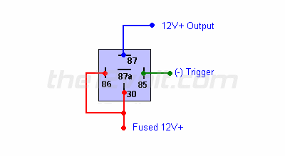

I want an aux channel on my alarm to turn on neon underbody lights, and then set that channel so 1 push would turn them on, another push turns them off. Anyways, that wire has a -500ma output, so I would need to use a relay. Here is the relay that is on here: relay for alarm to turn on neon lights -- posted image.
In my alarm manual, they have pins 85 and 86 switched. 30 and 85 are fused 12V+ and 86 would be the aux wire from alarm. Why are they different and does it matter which one I use?

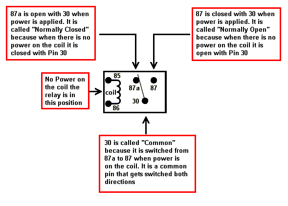

audioman2007
Copper - Posts: 580
Joined: February 20, 2007
Posted: March 18, 2007 at 6:13 PM / IP Logged
So I should wire the relay the way I have it in my diagram?

Posted: March 18, 2007 at 6:16 PM / IP Logged
85 and 86 can be either (+) or (-) but they have to be opposite polarities. You would need a flip flop relay to accomplish what your wanting or the alarm system has to have the ability to have the AUX channel be latched.

audioman2007
Copper - Posts: 580
Posted: March 18, 2007 at 7:13 PM / IP Logged
Yea, I can program that channel to be latched which is what I will do. So it doesnt matter if I use the diagram above, or have 85 and 86 switched. I just have to make sure one of those connects with 30 for 12V and the other be - trigger, correct?
Velocity Motors
Moderator - Posts: 12,488
Joined: March 08, 2002
Location: Manitoba, Canada
Posted: March 18, 2007 at 11:06 PM / IP Logged
You are correct.
