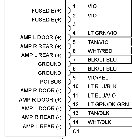

hi bnluis do you know the color codes for the speakers on the infinity amps
thanks

where is the factory amp, 2002 dakota -- posted image.
Keep in mind this are the wires going from the amp to the speakers. The front speakers and the tweeters are connected together.
