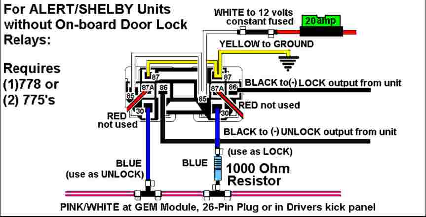

Ok someone help i am lost i have a freedom 500 asking for a Door+ and a Door-  does anyone know which is possitive and which is neg or what do i connect the two black wires on the relays too. Thanks
2002 ford escape, freedom 500 -- posted image.

If its asking for "door neg or positive" it is talking about the door trigger which is (-) PURPLE / lt. green 22 pin plug @ GEM . You only need to hook up the neg. wire of your alarm. As for the relays , the side with the resistor needs to be hooked up the (-) lock wire of the alarm and the other black need to go to the (-) unlock wire of the alarm.

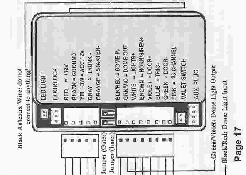

Ok still not sure here is a copy of the alarm book it already asks for a trig- which is blue comming out of the alarm 2002 ford escape, freedom 500 -- posted image.

O.K. now that my neck hurts...lol.....it looks like the blue wire is just for a hood pin or a trunk pin or any kind of input trigger. Should not be neccesary for proper function of the alarm. Hook the green wire to the door trigger of the vehicle.
mikvot
Gold - Posts: 1,043
Joined: December 19, 2006
Posted: March 26, 2007 at 9:16 PM / IP Logged
also, you will not need to use the violet wire.

no,......the green wire is to the(-)  door trigger of the vehicle The door trigger tells the alarm when a door is opened............the relay setup you have above if for the doorlocks of the vehicle, .Which need to go to the doorlock outputs of the alarm.(next to the led plug of the alarm)
