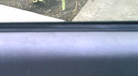

my overall question is how do you attach the FG to the panel at the edges, and how would i go about doing the top...with the weatherstriping.
94 eclipse, door panels -- posted image.
cam didn't want to focus on the door...just on the ground

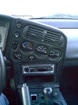

these are later projects i'm planning also
total redesign...stereo higher for easier access, vents seperated into two individual vents sitting straight instead of angle, HVAC at the bottom where stereo is now...then i will continue down to the middle console lowering it by about 1/2 inch for the short shifter, and continuing back for placement of distribution block and cap under plexi or lexan, and a design, not thought up of how to do yet, of a possible arm rest and a tv with game console in the back of arm rest for my kids.

any other ideas, let me know... and don't forget... door weather stripping and panel edges...what's the trick?

should i just peel off the rubber seal at the top of the panel and reattach with glue or something when i'm finished or just tape it off and fg up to it

I would start small.  I'm guessing this is your first time working with fiberglass?
An important thing for you to know is that fiberglass does not bond well with plastic.  It may bond at first, but it will eventually begin to lift.

I have done cosmetic fg to dashes, panels, bodykits, and boxes, but not to a door panel. When i did panels, the fg would start to lift if it wasn't continued around the edges of the panel. I still don't know how to prevent that except for changing mounting locations. That's why I want to do the entire door panel instead of just a pod. The majority of the panel is plastic, and there isn't a lot of room to wrap the edges unless I do some trimming first. But it kind of makes me nervous going to the extreme for a door panel, and i'm still not sure about the window seal at the top. I took it off and looked at it the other day, it's glued and clamped onto the edge. I've also been looking around for some spare panels to practice on or even do the work on and just swap with the current ones, no luck yet.

maybe you could make a mold of the top portion of the door panels as well as the edges.  The you could use it to make a replica of certain parts of the panel that you don't necessarily want to modify.  After you make the molds, you could even cut off the top edge of the door panel and epoxy it to the top of your replica.  That would take careful trimming of both the panel and the replica, but maybe you could pull it off.  That way you could just use the factory edge and not have to worry about that portion.  To me, that sounds really tough to execute.
Or, you could simply remove the panel and hack away at it.  Cut everything off except the edges and/or key structural mounting points.  Then you could use a combination of wood and fiberglass to create the shape of the new door panel that will almost be an insert within the outline of the old panel.  You could epoxy those together...  Bottom line, it's gonna take a bit of creativity and extreme patience to really pull it off.  Otherwise you're gonna end up with something much uglier than the original panel!
