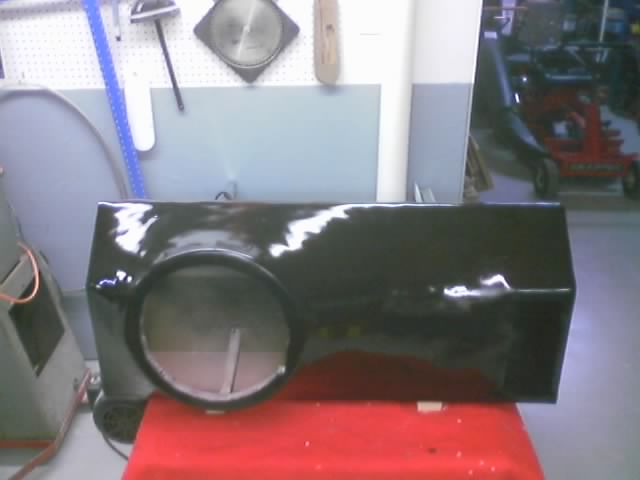

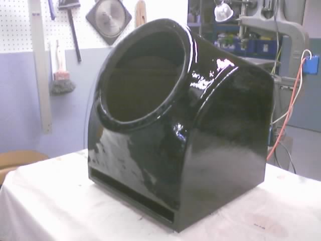

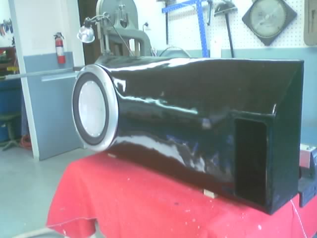

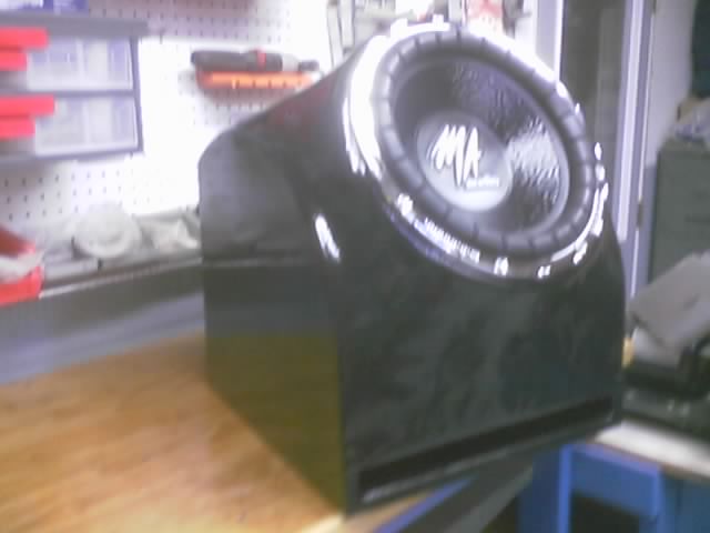

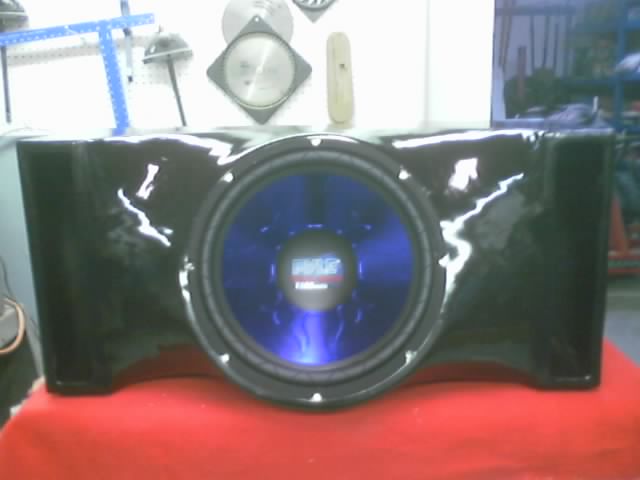

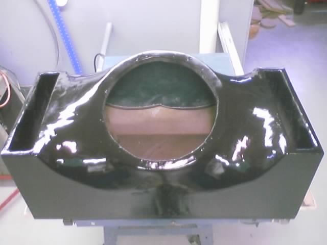

Im 16 and have been working with fiberglass for a few months now, but i seem to keep runing into the same problems. i always get small pin holes,and waves in the glass. im thinking that im sanding down the bondo to much what makes the wave. Hopefuly someone can direct the right direction.
here are a few picture of FG jobs ive done for friends.
15" pyle blue way- Honda civic
first few fiberglass projects -- posted image.
12" MA AUDIO- chevy blazer
12" RockFord Fosgate P3- Chevy silverado reg. cab

Use a 3M sponge snading block to sand the project instead of an type of air tools. This will give you alot more control of hoe deep your sanding as well as it will not wave your project. If you want to get rid of the pin hoes, you need to apply a high build primer to fill in the holes.

don't use so much filler. only a very thin layer should be applied. Also from time to time, spray the enclosure with a black paint or filler primer to see any waves and sand them doen. Glazng spot putty or resin/filler can fill holes.
