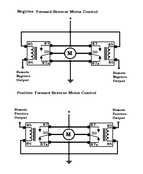

nice challange. Lets start with the basic circuit. Pick which one best fits your alarm.
will this burn up actuator? -- posted image.

mrcanngo
Copper - Posts: 63
Joined: March 17, 2007
Posted: April 08, 2007 at 1:32 AM / IP Logged
thanks for the nifty diagram wizard!
Maybe i''m not understanding right but is this assuming i have 2 negative outputs available?
Sorry for my ignorance. I wanted to baiscally have the polarities swap sides all in one button push using just one negative output from alarm (since thats all i have).  From what i understand, please correct me if i'm wrong: The diagram you proposed makes it so that if i push the button once, it will unlock, push again and it will lock right?
hotwaterwizard
Silver - Posts: 1,350
Joined: December 11, 2003
Posted: April 08, 2007 at 1:50 AM / IP Logged
This diagram has a seperate lock and unlock signal. Here is why I picked this one.
You only need one function by what you say. unlock function. Now we figure out how to hook the constant to momentary circuit to the other side for automatic locking action.
I need to know if we have a Negitive pulse or a positive Pulse.

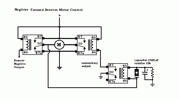

hotwaterwizard
Posted: April 08, 2007 at 2:23 AM / IP Logged
Here is what I came up with so far.
The Diode is a standard diode like 1N2001 1N2002 1N2004
it stops the coil from dammaging the capacitor and resistor.

mrcanngo
Copper - Posts: 63
Posted: April 08, 2007 at 2:28 AM / IP Logged
i have no idea if that will work but i trust your opinion because of all your other posts that i have read.  Btw, i know the squiggly thing is a resistor and the one to the left of it is a capacitor, but what is the one to the left of that? a diode of sorts? if so, what rating diode should i get?
