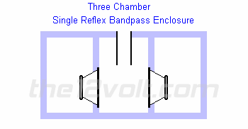

i need the specs for a three chamber single reflex enclosure for two 12 " solo x going into a nissan altima ported through the rear seat and port and box measurements if can in w,l,and h.and i also want a square port thanks

yhea i deffinitly do have power with 150 amp high output and batteries and caps but when i say three chamber is two seprate sealed chambers inside that the speakers face eachother and the middle chamber which is where the port comes out from

got a pic of this??

2 solox 12 enclosure -- posted image.
I can't help you with this one.  But http://diyaudiocorner.tripod.com/formula.htm has a section on this type of alignment and might help you out.  Note that it warns:  "Bandpass enclosures are best designed with a good software program, as tuning and enclosure changes can produce endless alignment variations viewable on your pc."
