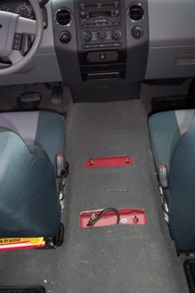

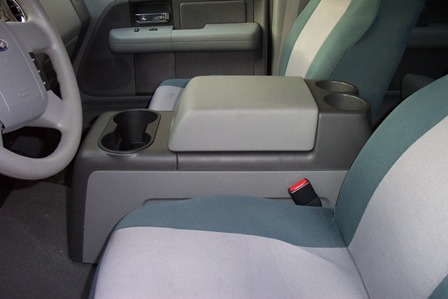

I had a pair of RF 10's that have been sitting in a box for 2 years now and I finally decided to do something with them.  Instead of the typical under the rear seat install I wanted to do something different.  I pulled the factory center console out and used its profile as a template for my new box.  Of course I lost a lot of storage and 4 cup holders, but what's more important? I also reused the 4 bolts that mount the console to the truck.

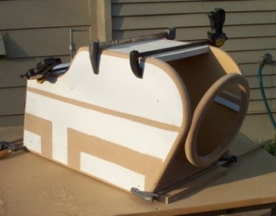

I made my frame from some scrap MDF that survived the Hurricane.

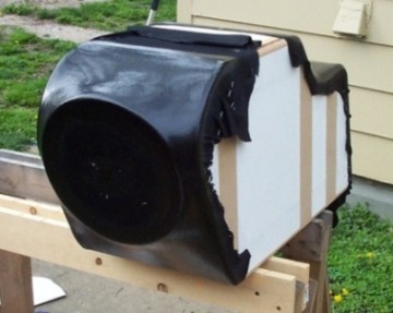

I used an old pair of my wifes pants for the first layer.  Shhhh, she didn't notice yet.
simple console project f 150 supercrew -- posted image.

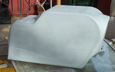

I don't have any pictures between this one and the primer, I was so tired from the glass, resin, filler, and sanding I didn't take any pictures. But you know what that looks like anyway.

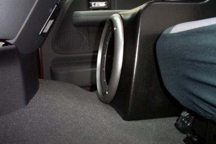

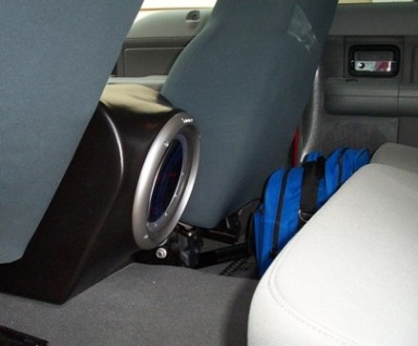

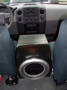

If I had to do it all over again, I would probably do everything different, and I would have just painted it rather than try the truck bed liner stuff.
