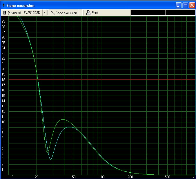

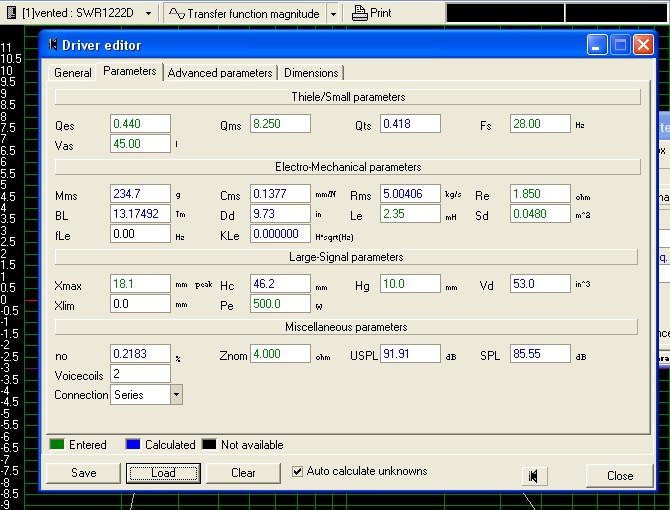

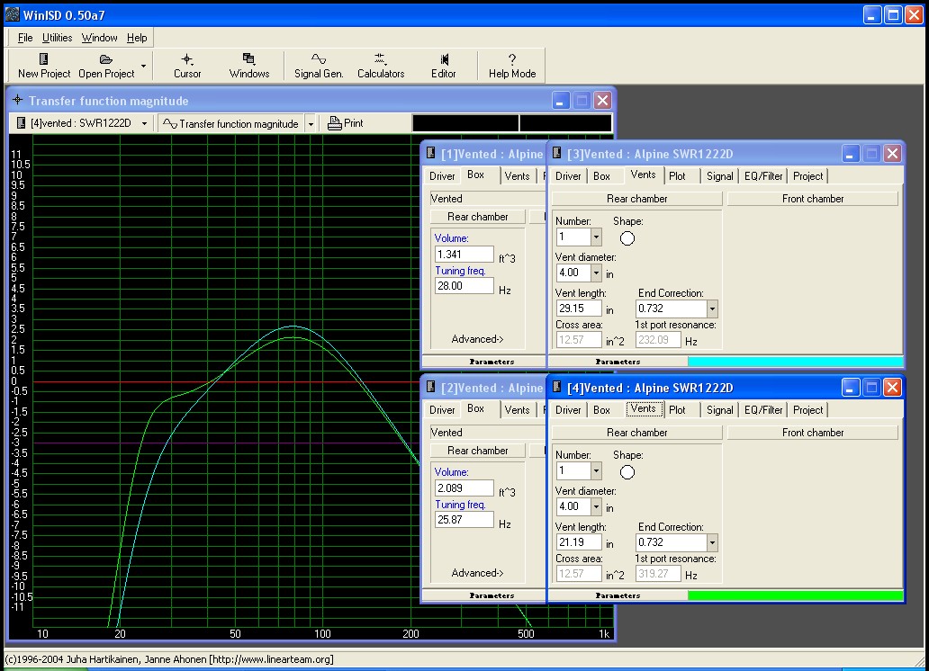

Looks like Alpine has changed their website to a less friendly format.  I did at one time, however, get the parameters for this sub from the site and have them in my WinISD database.  Here is what it looks like:  swr1222ddatabase.jpg
Note that this sub is a DVC 2 ohm model.  It will wire to 4 ohms (or 1 ohm).
These are default alignments in WinISD Pro.  Only change I made was vent diameter to 4" instead of 4.02, and gave 400 watts as power input.  Blue is (Super-) Boom-box and green is (Sub-) Chebyshev:
And this is cone excursion for these alignments:  alpinjeswr1222dexcursion.jpg
