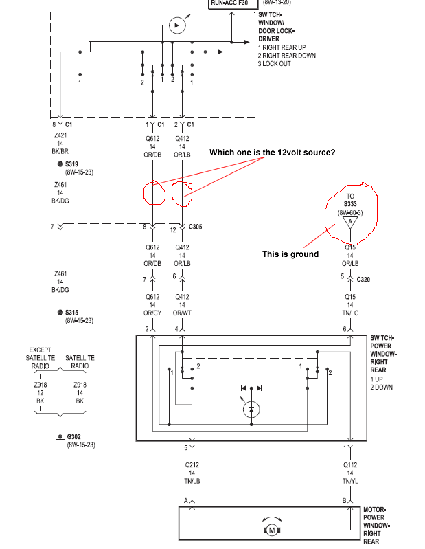

Can you guys help me out. I need answer to the question in the diagram. Thanks,
2005 dodge ram power windows conversion -- posted image.

I figured it out. They both need feeding since one works for up and the other for down. I connected it all with my ghetto rig and a 12v DC transformer and it worked. I cant wait to connect it all. Now I dont need the wiring harness. I know how this crap works now. I am sure glad I found the service manual.
