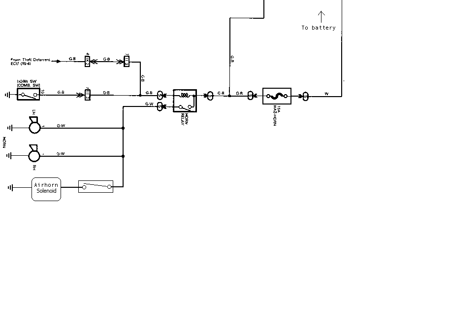

Hi all,
I've drawn up a circuit diagram before installing my electric air horn. I've drawn my modifications (in red) onto the car's wiring diagrams. Does my approach make sense? Is there anything missing/unnecessary?
Sorry bit of an electrical newbie. The idea of the switch marked with the big black arrow is: when open, only stock horn responds to pressing the horn button; when closed, both respond.
Thanks in advance!

iblis
Member - Posts: 19
Joined: April 06, 2006
Location: Ireland
Posted: April 20, 2007 at 10:27 AM / IP Logged
That earth to the right of the relay shouldn't be there... I was sure I erased it!   air horn circuit diagram is it correct? -- posted image.
iblis
Member - Posts: 19
Location: Ireland
Posted: April 20, 2007 at 10:30 AM / IP Logged
"Correct" diagram below:
http://mr2oc.co.uk/modules/coppermine/albums/userpics/14067/nautilus2.gif
hotwaterwizard
Silver - Posts: 1,350
Joined: December 11, 2003
Posted: April 21, 2007 at 5:44 PM / IP Logged
Please Explain why you need a Relay. ????>??????
An air horn Solinoid uses about the same current as the Relay. Why do you need a Relay. You only need a Relay for a Regular horn.

hotwaterwizard
Posted: April 21, 2007 at 6:06 PM / IP Logged
Here is a simpler diagram.

hotwaterwizard
Posted: April 21, 2007 at 6:43 PM / IP Logged
Keep it Simple.

hotwaterwizard
Posted: April 21, 2007 at 6:51 PM / IP Logged
Even Better!

dualsport
Silver - Posts: 983
Joined: September 27, 2005
Posted: April 21, 2007 at 7:52 PM / IP Logged
If the air horn shown in the original diagram is the actual compressor and not a relay, then it does draw a lot of current, so that may be why the separate 20A fused circuit was added to supply the air horn.
In any case, the control for the air horn has to come from the right side of the horn connections, like Hotwaterwizard shows, because the other side is grounded. Adding that diode in line with the RH horn will do nothing; though it might seem like the current flows that way and you could tap off the signal from the diode output, it doesn't work that way. Once it hits ground, it's ground.
If the box shown for the air horn is supposed to just be a separate relay controlling the air horn compressor, then simply wire it as shown by Hotwaterwizard; if not, then just add a relay. No need for any diodes, because you're not dealing with any electronic drive circuitry and don't need to isolate anything.
iblis
Member - Posts: 19
Location: Ireland
Posted: April 22, 2007 at 6:50 AM / IP Logged
Hi all,
Thanks for all the replies! As above, I'm not very experienced with this stuff, so apologies if any of the below is crazy talk air horn circuit diagram is it correct? -- posted image.
The airhorn box is an electric compressor (should have been clearer about that). The switch is to go in the cabin, so I figured the relay would be a good idea rather than wiring higher gauge cable all the way through to the cabin.
I'm not sure if the existing horn wiring is high enough gauge to safely carry the compressor's current, so that's why I put a seperate 20A fused feed.
Are either of those correct?
Thanks again.
dualsport
Silver - Posts: 983
Posted: April 22, 2007 at 8:06 AM / IP Logged
This should be all you have to do-
https://img293.imageshack.us/img293/3449/aircompressorcntldx0.jpg
diagram
