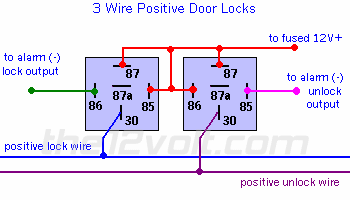

I was thinking of using a momentary toggle switch for up and down (press up, the cover would rise to it's up-most position, press down, it would close). Then I would connect this up to a couple aux channels on my alarm and be able to do it from the fob. Basically, use this relay setup for a 3 Wire Positive door lock system, at least to do teh latching... the unlatching would be triggered somehow by a pin switch when the top is closed...

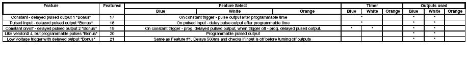

The PAC TR7 will do what you want. Take a look in the undocumented instructions from the web site it mentions a delayed pulse output in step 18.
