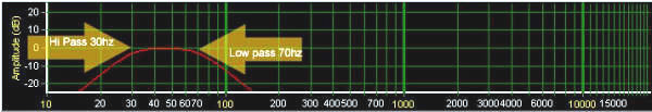

In a nut shell what we want to do here is combine a subsonic filter as a high pass crossover together with the normal low pass crossover that you use with all subs. These two crossovers make an electronic band pass.
sub enclosures with electronic assist -- posted image.
Here you can see what this looks like at the electronic level in a frequency vs. amplitude plot

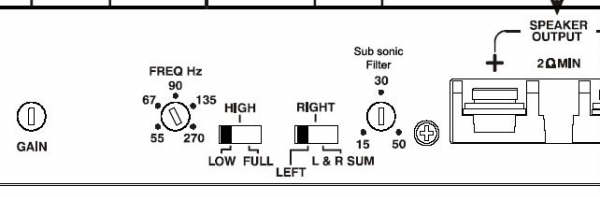

And here you can see what the settings on an amp might look like to accomplish this.

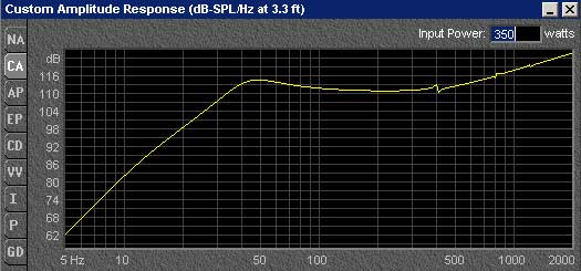

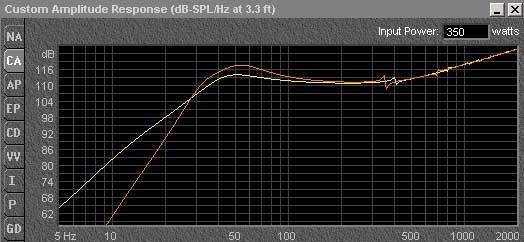

This is how the IDQ12’s response looks in the factory recommended 1.5 cu.ft enclosure in free space.
Now if I reduce box size to 1 cu.ft, retune to 32hz and add a subsonic filter at 32hz and 6 db of boost at 32hz I can achieve roughly the same thing in a smaller box.
Here the orange line represents the frequency response of the 1cu.ft enclosure. The F3 is an almost identical 29.49hz and this arrangement will play louder at all frequencies across the entire pass band. Notice how much faster the orange line drops off below the F3 down point. This is because we have created a higher order enclosure. Once this enclosure is loaded into a vehicle the 1 cu.ft enclosure will only have slightly less output (about 3 db) than the 1.5 cu.ft counterpart between 20 and 25hz. This is well below most program material. Unless you are listening to test tones this is pretty much impossible to perceive in this case.

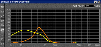

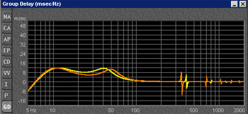

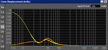

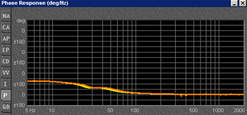

As you can see from the graphs below, cone displacement, vent velocity, phase response, and group delay are all well with in acceptable ranges as well.

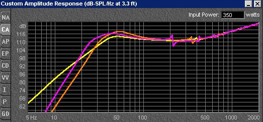

Now lets say that you have room enough for a decent sized enclosure and you just want to maximize performance as a whole. You might want to try something like this on for size.
1.5 cu.ft, Fb 27hz, F3 23.51hz (pink line)
This time with subsonic set to 25hz, and 6 db of boost at 25hz
As you can see this setup will play deeper and louder with better cone control at very low frequencies. This type of setup is also ideal for marine and convertible top applications where the sub fires out into the open and there is no cabin loading that you can take advantage of.
