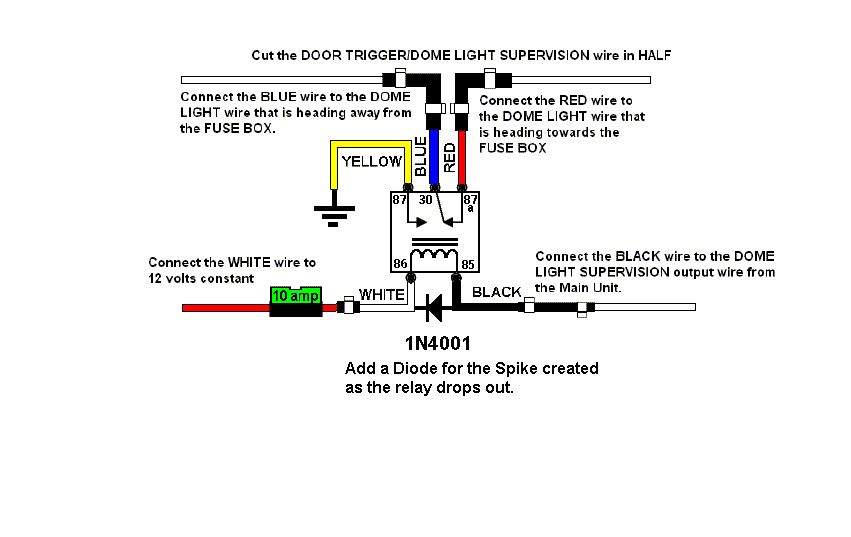

hi guys could someone please tell me is it possible to modify the relay diagram below to bypass the dome light delay on a 51 plate fiat punto as it keep triggering my alarm   thanks in advance     rich
Here is the same drawing modified with the Relay contacts drawn in so you can see what is going on.

More explaining is needed I don't understand what you are trying to do.

my dome light stays on for about 15 seconds when i lock the doors so the alarm thinks the doors are open and triggers the alarm

I would Just add another pin swith for the alarm instead of using the one for the dome light.

thanks do you mean add a pin switch to every door to trigger the alarm                    thanks for advice rich

Yes, Then you don't have to mess with that stupid Light Supervision Circuit board.

what kind of alarm is it?
if it has dome light delay feature,enable it,this will cause it to ignore the dome light being on while arming.
