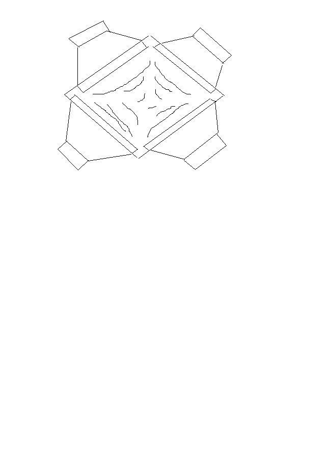

I am afraid that I don’t understand what you mean by “dual diamond”. Is this what you mean?
how to design ports -- posted image.

a dual  diamond is where four sub will face each other ina a square config. slightly tillted of center. they all have a intersecting wave in the middle and it comes right out on your head. ive only done this with four or more fifteens so not to sure what it sound like w/ twelves it is used to create deeper and smoother bass.how to design ports -- posted image.

Pointing the subs towards each other in that type of arrangement will not have any direct effect on the sound. The subs are to close together to each other to create any type of variation in response due to standing waves between the subs, and the opening is to large to make the space between the subs act as an independent resonating chamber. The subs will have a slightly increased output due to mono coupling but, this would also happen if the subs where all lined up on a flat surface and positioned close together. The advantages to a design like that is the fact that you might be able to squeeze all of those subs in your ride and it might be cosmetically pleasing.
