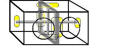

There are a lot of ways to add bracing; just keep in mind that it is the very center of each baffle expanse that is most subject to flexing.  Bracing from center to center is ideal but not always possible, such as from center front to center back.  So, brace as close to center as you can.
enclosure bracing -- posted image.
This pic illustrates one of a number of ways to use up scrap lumber to make the braces.  A common way is to use a full size interior baffle and rout large holes in it, as was described above.

oohhhh  look at the pretty colors!!!  nice illustration stevdart!

skeleton bracing is what it is called IRC
I've read you ideally want to make them slightly off center so you don't have two of the same size panels that will have the same resonance.  Maybe that's looking to much into it though.
