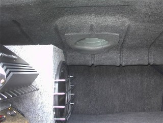

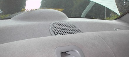

I'll throw up some old pics I"ve used a few times before:
running ports into the cabin - Last Post -- posted image.
In this car, there was an existing OEM subwoofer cutout that I used for the trunk-to-cabin vent.  Your imagination is your only limitation.  Your goal is to open the trunk cavity to the cabin so that the air pressure equalizes.  The sub is much stronger where it counts...where you sit...when an opening is made.
