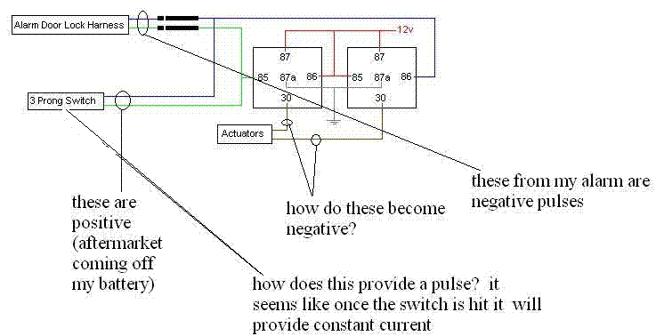

" b) OR ... the alarm/doorlock/keyless entry brain/lock/unlock switch will produce a positive + signal and this will drive a relay that will use GROUND as the ultimate negative potential that goes to the relay..."
Thanks for the quick response, I'm still a bit confused though I commented on a picture presented earlier that maybe will help illustrate my confusion.

peterubers
Silver - Posts: 706
Joined: December 29, 2006
Posted: May 25, 2007 at 10:11 AM / IP Logged
Do you see how 87a on both of those relays are connected to a perpendicular line with little narrowing lines pointed downward like an arrow --> that's the electronic symbol for GROUND.  The actuators REST (in this diagram) at ground (terminal 30 is normally connected to the 87a terminal), and during unlock/locking the circuit is connected from terminal 30 and 87 (12 volts), which supplies power to the actuators to move the mechanical doorlock whichever direction.
The search function is your friend.
peterubers
Silver - Posts: 706
Posted: May 25, 2007 at 10:15 AM / IP Logged
That three prong switch -- the blue and green wires .. those should be grounding (or negative wires) when you press either lock or unlock -- they may REST at positive, but when you press the button (the swtich in lock or unlock) it must connect the circuit to ground (negative).
that switch has to be grounded somewhere, otherwise, if you trace it back to the relays, it's just providing a positive charge at all times to the 85-86 relay solenoid.  When pressing the lock or unlock (hence three prong, two of the prongs are positive, one is ground) the relay will see ground and cause the circuit to switch from 87a to 87 --> initiating the actuation of the actuators.  And that three prong switch should be spring loaded on both sides --> i.e. it's not a flip switch --> it's like a dual-momentary switch as is a typical lock/unlock switch on any factory power door lock switch
peterubers
Silver - Posts: 706
Posted: May 25, 2007 at 10:22 AM / IP Logged
any i don't quite understand what you mean by the GREEN/ blue wires being "positive coming off your battery"

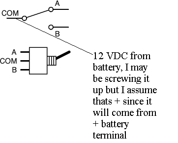

Posted: May 25, 2007 at 10:27 AM / IP Logged
This is what I'm thinking, should that com be ground?
negative potential -- posted image.
jurb
Member - Posts: 39
Joined: May 23, 2007
Posted: May 25, 2007 at 10:28 AM / IP Logged
Obviously A/B would be lock/unlock. If that is correct does that mean I need to leave the switch in the middle position after locking/unlocking?

Posted: May 25, 2007 at 10:36 AM / IP Logged
COM should be connected to CHASSIS GROUND, according the previous diagram of the unlock/lock relays.
It looks like you have a toggle switch -- I have never seen that used for an aftermarket door lock system.  I've only seen momentary switches.
Do you see how if COM is always supplying 12 volts (either in the COM-A or COM-B circuit setting) .. then it'll always ben providing a 12 volt positive + charge to the 85 terminals on the unlock and lock relays and therefore the circuits of those relays will NEVER be switched from 87a-30 to 87-30 --> therefore they'll never initiate the actuators.
Which directions are you using to install this system?
peterubers
Silver - Posts: 706
Posted: May 25, 2007 at 10:40 AM / IP Logged
The 12 volt power for the actuators is coming from terminal 87 on each of the above relays.
If you use a toggle switch, you can't leave it in the middle -- it's either up or down.  Therefore the circuit will always be drawing juice and you'll blow a fuse.  I'd look into a momentary switch
