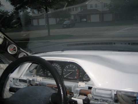

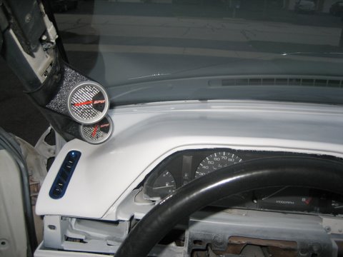

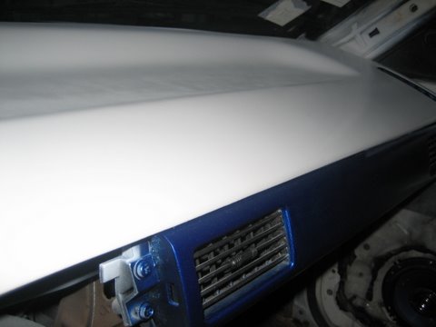

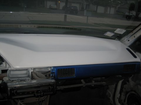

I'am working on my 92 mazda protege and all i did was sand the dash down and use a high build primer to fill in the pin holes and stuff like that. After the wet sanding and preping I use Krylon Fusion spray paint for plastics and it came out pretty good I'll post some pics for you later.

Here's how my dash came out so far....

Looks pretty slick!
I would like to see even more pics.
great job.
