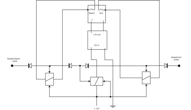

I was also thinking about the spare remote idea.  Using 2 relays and a 12V to 1.5V voltage regulator, I think I could wire it up to arm and disarm based on the keypad output.
I'm going to draw up a diagram and see what you think.

How about this setup?
I think there needs to be some capacitors added to keep power to the transmitter longer and to the arm / disarm buttons, but I'm not sure what value.  There might also need to be some more diodes.

Only 1 of us has to carry a keyfob, the other can simply use the keypad on the door to get into the car and lock it again.
I appreciate the effort, and the desire to do something wild, cool, and out of the ordinary. The diagrams and all. Neat stuff.
But, what is your time worth. My time wouyld be worth more than the cost of another transmitter.  Just a thought. AND, I'm not shooting down your idea....it's really a good one. specially to use that piece that BigDog found.

Well, we tend to keep our cars a LONG time.  Our last expedition we kept for 10 yrs and the only reason we replaced it was because it didn't have 3rd row seating, otherwise I'd plan to keep it another 10 yrs.  So, it would definitely be worth the extra $150 or so bucks to add an extra transmitter if it could be done.  Unfortunately, I'm not handy enough to know what needs to be isolated etc, so I need to find someone who understands this stuff better to help me out.
What I'll probably end up doing is just waiting for the new Code-Alarm unit to come out.  It has a 1mile range and a couple extra inputs for arm / disarm.  I know they're not the best quality of alarm, but it's the only one that has the arm / disarm input and it doesn't look like I'll be able to figure out the wiring for the Viper unit without some help.
