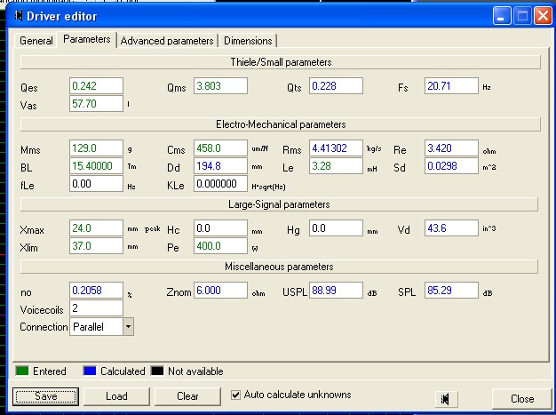

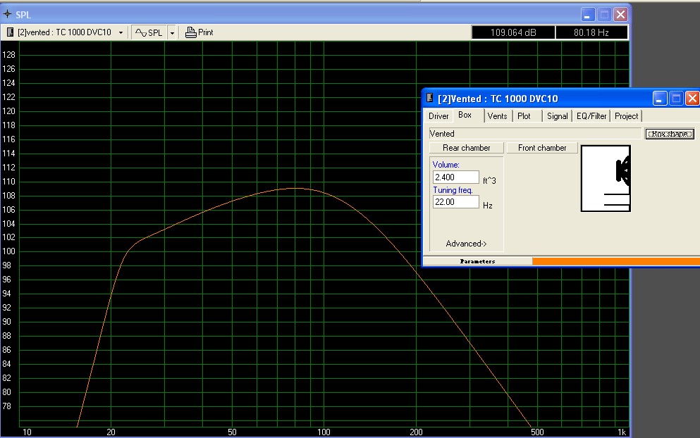

Tell me if these look about like what you are seeing, in WinISD...
for dave -- posted image.
Those are the parameters I used in JBL Speakershop
That's the first plot, with cabin gain assumed.
And here is what the power and impedance plots look like... (lower right graphs)
Do these seem possible at all? Note the vent is area, not round... I can still safely assume a vent velocity of .06M, which should be pretty damn silent. I know there is a horrendous peak, but I'd rather have a peak than a dip! Note there are no filters applied here, JBL doesn't have the capabilities for that, but I will be applying a subsonic @ (around) 23Hz, and a low-pass no higher than 55Hz. This IS a tough driver to model...
