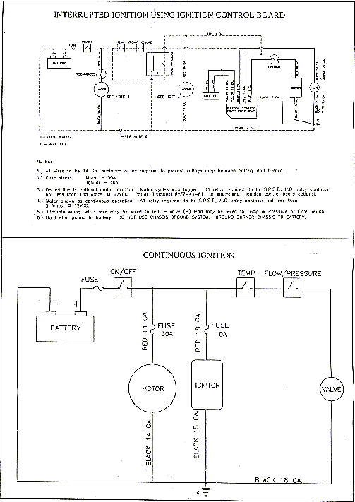

hotwaterwizard
Silver - Posts: 1,350
Joined: December 11, 2003
Posted: June 19, 2007 at 12:52 AM / IP Logged
relays electric after run water pump -- posted image.
John DeRosa (Hotwaterwizard)

hotwaterwizard
Posted: June 22, 2007 at 8:42 AM / IP Logged
I like switching the Hot. A short is a short and I see no difference in performance.
You see I work on Hot Water Pressure Washers and they always switch the Hot.

KPierson
Platinum - Posts: 3,527
Joined: April 14, 2005
Location: Ohio, United States
Posted: June 22, 2007 at 10:50 AM / IP Logged
As long as the line is properly fused it really doesn't matter.  In a car, it is typically more convenient to switch the (-) because you don't have to run two wires (you can ground the switch at the switch).  However, if you are already working under the hood it really isn't going to save much.

dualsport
Silver - Posts: 983
Joined: September 27, 2005
Posted: June 23, 2007 at 7:59 AM / IP Logged
By all means switch the hot side if there's a reason for it. It's done with light fixtures for safety reasons because you don't want 115V sitting on the base of the bulb socket when the light fixture is off.
For relays, there's an advantage to ground switching because it's easier to find a local ground source for the switch than a 12V source, allowing the use of a single control wire. Most electronic controls such as alarm modules use ground switching for the relays.
If it's not possible to use ground switching if your specific situation, then go the other way- either way works; just consider the options.
