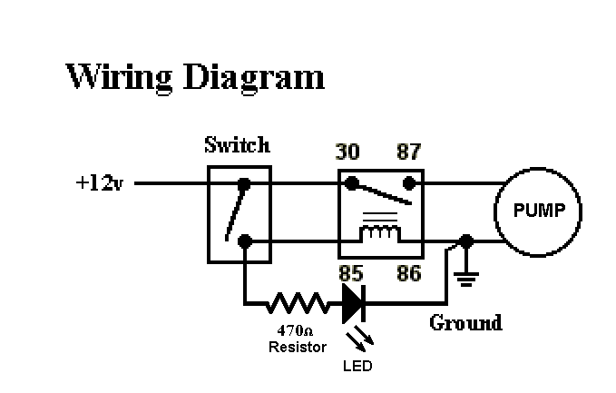

Here is a Diagram You can ommit the resistor and Led if you don't want a light to let you know when it is on.
relay for water injection -- posted image.
